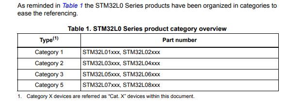

STM32L40? You mean the L0 Cortex-M0 parts? The L4 parts are entirely different designs, and aren't categorized in the same way.
Perhaps pull the Reference Manual for the part, and see what die it is using? There are currently at least 5 L4 die, identifiable via the DEV_ID
The Data Sheet should also provide guidance on package and function demarcations.
