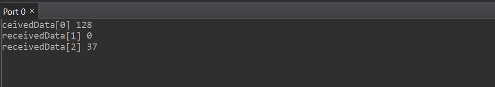

Apologies, you were absolutely right — I was mistakenly reading only one byte and not using HAL_SPI_TransmitReceive properly. I've corrected the code to send the command 0x25 followed by two dummy bytes (0x00, 0x00) in a single transaction to read the ACC register.
However, now I’m facing a new issue: no matter what value I set for ACC, when I read it back, I always get 0x80 0x00 0x89 (i.e., 128 0 137). I double-checked the write sequence as well and it appears to complete successfully.(I am able to execute run command)
I’ve also attached the image and my updated code for reference. Any suggestions on what I might be missing?
Additionally, I’ve already set all KVALs and MAX_SPEED to their maximum values, yet the motor won't go beyond ~1000 steps/sec. Beyond that, it starts vibrating heavily and doesn’t rotate at all, I am using NEMA 17 and NEMA 23 with 24v Supply and tried with no load condition and with some load as well. Phase resistance for NEMA 17 is 3.3R and NEMA 23 has 2.23R
I've attached an image and included my updated code for reference. Any suggestions on what I might be missing would be greatly appreciated.
Thanks again for your help and patience!
