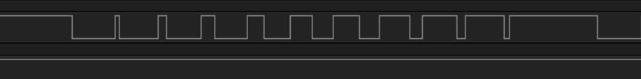

DMA config as below
hdma_tim.Instance = TIMx_CC1_DMA_INST;
hdma_tim.Init.Channel = DMA_CHANNEL_6;
hdma_tim.Init.Direction = DMA_MEMORY_TO_PERIPH;
hdma_tim.Init.PeriphInc = DMA_PINC_DISABLE;
hdma_tim.Init.MemInc = DMA_MINC_ENABLE;
hdma_tim.Init.PeriphDataAlignment = DMA_PDATAALIGN_WORD;
hdma_tim.Init.MemDataAlignment = DMA_MDATAALIGN_WORD;
hdma_tim.Init.Mode = DMA_CIRCULAR;
hdma_tim.Init.Priority = DMA_PRIORITY_HIGH;
hdma_tim.Init.FIFOMode = DMA_FIFOMODE_DISABLE;
hdma_tim.Init.FIFOThreshold = DMA_FIFO_THRESHOLD_FULL;
hdma_tim.Init.MemBurst = DMA_MBURST_SINGLE;
hdma_tim.Init.PeriphBurst = DMA_PBURST_SINGLE;
HAL_DMA_Init(&hdma_tim);
/* Link hdma_tim to hdma[TIM_DMA_ID_CC1] (channel1) */
__HAL_LINKDMA(&TIMx_handle, hdma[TIM_DMA_ID_CC1], hdma_tim);
/*##-2- Configure the NVIC for DMA #########################################*/
/* NVIC configuration for DMA transfer complete interrupt */
HAL_NVIC_SetPriority(TIMx_DMA_IRQn, 2, 4);
HAL_NVIC_EnableIRQ(TIMx_DMA_IRQn);PWM generation code +++++++++++++++++++++++++++++++
TIMx_handle.Init.Period = 50;
TIMx_handle.Init.RepetitionCounter = 0;
TIMx_handle.Init.Prescaler = 0;
TIMx_handle.Init.ClockDivision = TIM_CLOCKDIVISION_DIV1;
TIMx_handle.Init.CounterMode = TIM_COUNTERMODE_UP;
/*##-1- Initialize the timer in time base generation mode ##################*/
HAL_TIM_PWM_Init(&TIMx_handle);
/*##-2- Configure the PWM channels #########################################*/
/* Common configuration */
TIMx_sConfig.OCMode = TIM_OCMODE_PWM1;
TIMx_sConfig.OCPolarity = TIM_OCPOLARITY_HIGH;
TIMx_sConfig.Pulse = 5;//aCCValue_Buffer[0];
TIMx_sConfig.OCNPolarity = TIM_OCNPOLARITY_HIGH;
TIMx_sConfig.OCFastMode = TIM_OCFAST_DISABLE;
TIMx_sConfig.OCIdleState = TIM_OCIDLESTATE_RESET;
TIMx_sConfig.OCNIdleState = TIM_OCNIDLESTATE_RESET;
HAL_TIM_PWM_ConfigChannel(&TIMx_handle, &TIMx_sConfig, TIM_CHANNEL_1);
/*##-3- Start PWM signals generation #######################################*/
HAL_TIM_PWM_Start_DMA(&TIMx_handle, TIM_CHANNEL_1, aCCValue_Buffer, SIZEARRAY);
uint32_t aCCValue_Buffer[SIZEARRAY] = {0, 2, 4, 6, 8, 10, 12, 14, 16, 18, 20, 22, 24, 26, 28, 30, 32, 34, 36, 38, 40, 42, 44, 46, 48};where SIZEARRAY is 25
Below image is for array size 10, came as expected
Below image is for array size 25, not good (I should see 25 different DCs)

Read out and check/compare content of DMA (and perhaps also TIM) registers for both cases.

Am using STM32F427.
I want to update DutyCycle of a PWM timer at every 2us, so I made an array of 25 values and called
HAL_TIM_PWM_Start_DMA(&TIMx_handle, TIM_CHANNEL_1, aCCValue_Buffer, SIZEARRAY);I have configurated DMA in circular mode.
According to my understanding I should get the below call back after full array gets updated.
void HAL_TIM_PWM_PulseFinishedCallback(TIM_HandleTypeDef *htim)
HAL_TIM_PWM_Stop_DMA(&TIMx_handle, TIM_CHANNEL_1);
}But this is not the case, each DU change this is getting called, is there any callback I get after full buffer is empty ?
Please help
