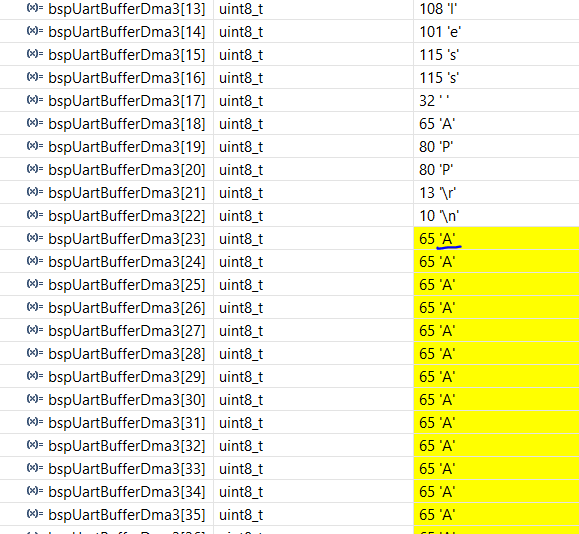

When used in interrupt mode, everything works fine.When used in interrupt mode, I cannot increase the baud rate because after a while the application crashes due to too many interrupts,  But when I receive in DMA mode, after a few characters are received correctly, it starts receiving the same character over and over again. It's in the buffer, and I don't understand what could be causing it. The same thing happens if I use the SPI + DMA serial port to communicate with the modem.
As you can see from the image, the first characters are correct. The interrupts arrive fine, but the buffer is incorrect. Always repeat the last correct character. The same thing happens if I read the data with the SPI peripheral; it just happens a little less frequently.It should be noted that here too I have to lower the clock frequency considerably so that this happens less often, compromising the communication speed during operations such as file downloads.

the same application works well with the STM32H723 micro but we needed more RAM
8 REPLIES 8
Saket_Om
Hello @franckngatcha
When using DMA on microcontrollers with data cache, such as the STM32U5 series, it is essential to manage cache coherency to ensure data integrity between the CPU and DMA. Before starting a DMA receive operation, you should clean the data cache for the target buffer using SCB_CleanDCache_by_Addr((uint32_t*)buffer, size); to ensure that any modified data in the cache is written back to RAM, making the buffer ready for DMA access. After the DMA transfer is complete, you must invalidate the cache for the same buffer with SCB_InvalidateDCache_by_Addr((uint32_t*)buffer, size); so that the CPU fetches the latest data from RAM, reflecting the changes made by the DMA.
Saket_Om
franckngatcha
Associate II
Hi Sacket,
DCACHE wasn't enabled, but I enabled it for testing. The SCB_CleanDCache_by_Addr and SCB_InvalidateDCache_by_Addr functions are available only on the STM32H723 micro but not on the STM32U585 micro. I added the command HAL_DCACHE_CleanInvalidByAddr(&hdcache1,(uint32_t *)bdiSpiMem_ScratchBuffer,spi_ctx.SpiHandle->RxXferSize); before reading the data from the buffer, and the command HAL_DCACHE_CleanByAddr(&hdcache1,buff,len); before sending the data. The result is exactly the same. After a couple of successful sends, I start receiving only the same character in the buffer, and the number of data that should be there is correct.
The more I increase the communication speed, the faster the problem arises.
Why are you setting the source and destination address both as FIXED in the dma setting?
Typically, one address should be incremented—the source for memory-to-peripheral transfers, or the destination for peripheral-to-memory transfers—so that data is moved sequentially and efficiently.
Saket_Om
Are you sure? DCACHE is on U5 only for external mems, internal RAM dont use it...
Maybe first check your config , for example this is complete fail
handle_GPDMA1_Channel0.Init.Request = GPDMA1_REQUEST_SPI1_TX;
    handle_GPDMA1_Channel0.Init.BlkHWRequest = DMA_BREQ_SINGLE_BURST;
    handle_GPDMA1_Channel0.Init.Direction = DMA_PERIPH_TO_MEMORY;
all TX require oposite directions...  etc.
Hi Saket_Om.,
Dcache was not enabled because i don't use it. at the moment i'm not using external memory
Sorry sacket,
i pasted all the configuration. at the moment i'm not using SPI1
just look at the SPI3 configuration

th thing is that it works for a moment and then it start receiving the same character and from that moment it stop working. i'm not getting any error on the DMA ( ovverun, underrun) i don't understand where the problem is .
DMA normaly cant over underrun is 1000:1 to peripheral speeed. And show config is important, but errors is in code . Manage DMA isnt simple...
Show how buffers you use how callbacks etc... And for error check SPI errors no DMA
Too GPDMA have Port 0 and Port 1, you allocate only 0 , try read docu.
