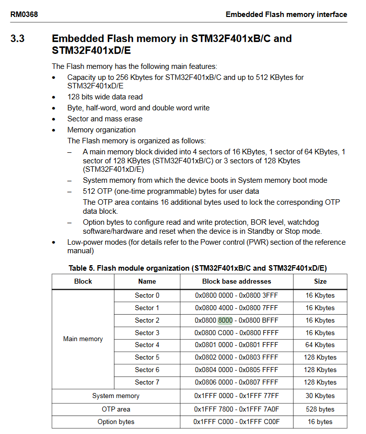

The STM32F401xD has 384Kbytes FLASH and the STM32F401xE has 512Kbytes FLASH.
Is there a mistake in the reference manual?
3.3 Embedded Flash memory in STM32F401xB/C and STM32F401xD/E
According to the manual STM32F401xD/E have the same number of sectors. I would expect that only STM32F401xE has an additional sector 7.
2022-03-28 5:27 AM
We are sorry that this was somewhat misleadingly expressed in RM0368.
Table 5 should be read as:
Does it answer our question?
