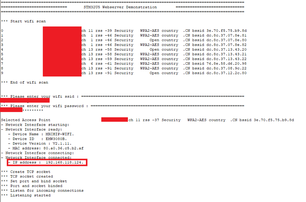

what web browser are you using to connect to the board's web server ?
2022-09-06 10:20 AM
I used chrome latest version on a windows laptop as well as on iPhone tried with chrome and safari
2022-09-06 10:21 AM
I tried this and after trying all available guidance on web I had no luck. I do get IP address from board but browser doesn’t open anything
2022-09-09 8:14 AM
Hello @tCHAP.1,
You need to be connected at the same wifi from where the IOT board is connected to, otherwise you can't open the web page with the provided IP address.
Mohamed Aymen
2022-09-09 8:59 AM
Thanks for your reply. For sure my other device is also connected to same AP. In fact I can ping to the module. It’s just that webpage not opening. I’m surprised that no one else has faced this issue.
