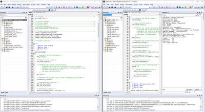

Hi @FBL .
Thanks for the reply with details.
Referring the image above I think that the enumeration process is working fine, after enumeration process when the communication begins, the host (being Nucleo F767) will send the data which is being received by the device (Nucleo-F767ZI), but when device sends any data (in loop back mode) that is not getting received on the host. I don't have any USB Protocol Analyzer to debug the communication between host and the device (both being Nucleo-F767ZI). I would like to mention one more thing is that the device with the same code I had provided you is working successfully with PC as host, both data transmit and recieve is working. As I'm just a beginner with the USB Protocol I need some guidance from you to move ahead. Please suggest if any corrections to the host or device code to be done, so that I can do the same thing to make the communication work with the host (Nucleo-F767ZI) from the device. I am now using STM32Cube IDE for development of the USB code, please consider the same.
