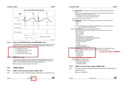

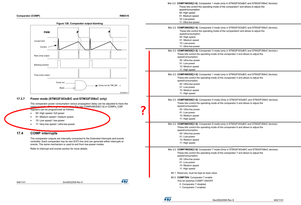

So, which is correct and which is wrong?
The same is in RM313 for 'F37x.
Would those who wrote/modified AN4232 pay more attention to checking the facts through actually writing test cases, rather than applying the "modern feel and look", this must have caught their attention.
AN4232 should also mention the dramatic increase in power consumption of the COMP modules in 'G4, compared to 'F3.
@Vincent Onde - a prime example of why it's in ST's interest of write dozens of appnotes per module, together with concise software examples; instead of just copy/pasting from RM and rephrasing.

Hi @waclawek.jan,
Thank you for pointing out this missing.
I will push to correct this in the next release.
