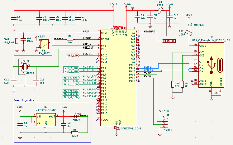

I have designed my own PCB and I have the problem that while the code uploads successfully, it doesn't run.
I have checked NRST and BOOT0 and both should not be the problem. I have found a similar issue where the chip didn't get a clock signal and therefor was stuck. I have used the debugger to step through the code and it went past HAL_Init but I never come past SystemClock_Config, when trying to step into it the debugger throws 'Cannot find bounds of current function'. I am new to designing PCBs and I don't really know where to go from here or what the issue could be.
It is not the debugger itself as I can run the blinking sketch with no problems on a dev board that I have bought, which is why I have attached the schematic. I can also provide the PCB layout but I think it is much more likely that I made a basic mistake than that the layout is the culprit.
Thank you

You have not connected anything to VCAP1, although 4.7µF must be connected to your UFQFPN48 (see data sheet, table 16)?

according to your schematic , NRST has no pullup resistor.
connect like 4.7k pullup resistor.

It is NOT recommended to use a pull-up at NRST, because it is already built-in.
You will find details in the reference manual.
[edit] Even though such pull-ups are familiar from MCUs of the last millennium and can be found in some horribly constructed Blue, Black or other Pills, this does not mean that they are actually recommended or useful. [/edit]
