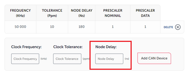

Hello @KDG ,
Watch this video on youtube, how to configure FDCAN timings especially @13:57
You need to use kvaser calculator from here: https://kvaser.com/support/calculators/can-fd-bit-timing-calculator/
Node delay to be put here:

2024-09-20 6:43 AM - edited 2024-09-20 6:44 AM
Hello @KDG ,
