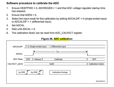

On a first step, I advise you to take a look at this errata sheet related to the STM32G431xx devices, in the ADC section and check if you have the same conditions as described in the document.
Make sure that the ADC is properly calibrated. For that, please follow the calibration procedure as described in the RM0440.
