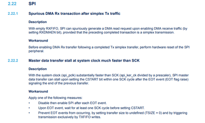

Hello @ToonToon ,
You can check and compare your code with LL SPI example available within STM32CubeH7 MCU package.
I advise you to read this AN5543 and the STM32H7 errata in SPI section to check if the limitation is part of your issue.

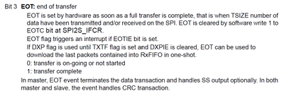

2024-02-22 6:38 AM
Need to set TSIZE if you want the EOT flag to work.
