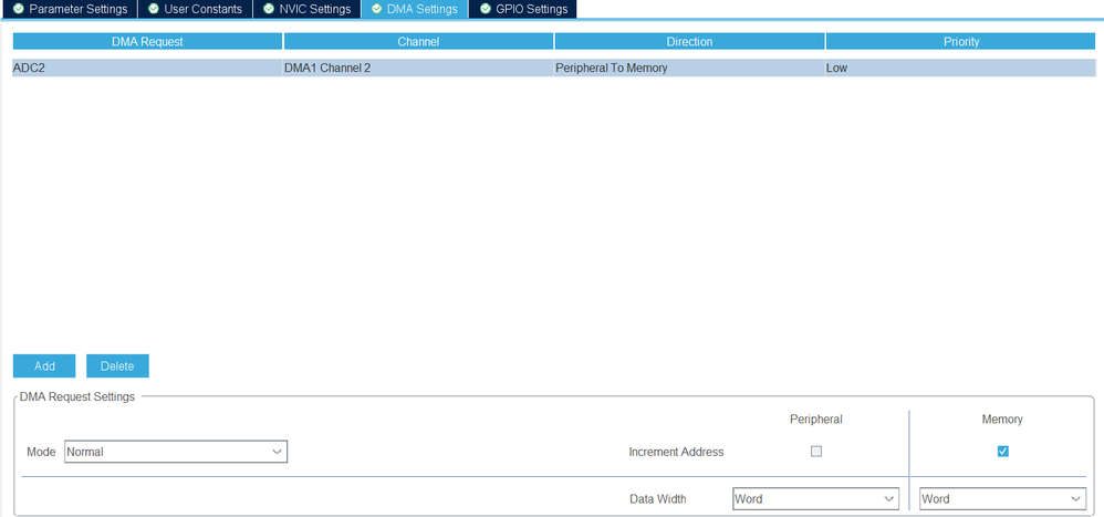

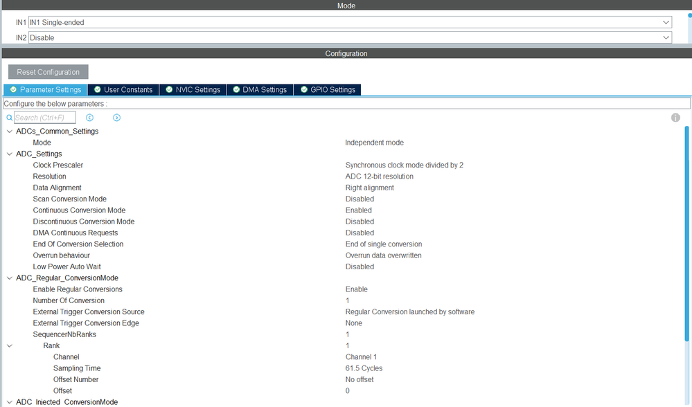

I am working on ADC setup using DMA, where upon the conversion completion the ADC values shall be transfered to memory using DMA. The ADC and DMA configurations are as shown in snap below.
The DMA settings are as follows.

When I run the code, the values in buffer AINW_DmaRawAdcData are zero and the DMA interrupt "DMA1_Channel2_IRQHandler" in not getting triggered. When I try to read ADC values using HAL_ADC_GetValue, the values getting updated. However the ADC + DMA combination is not working.
Please help me to resolve the issue. Let me know in case any additional information is needed.

It's strange, that HAL_ADC_Start_DMA uses uint32_t - the register is 32 bit but only the lower 16bit are "read bits" - I would propose to configure the DMA as half word.

I believe as the ADC value and DMA register are 32 bit words so a word transfer will also work there. However, I have tried with half word as well but still not working.

Data width should be half-word.
