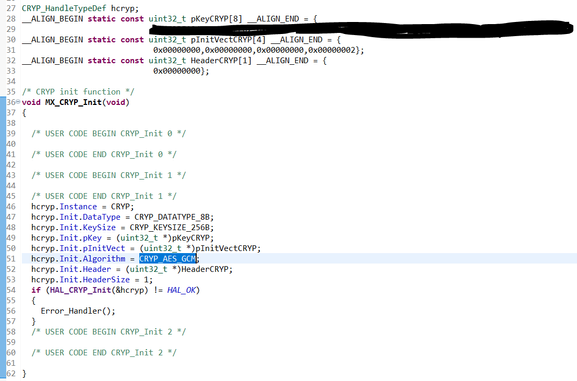

I'm developing a project with STM32H7.
I have a file on uSD and I can read it using FatFs.
I have to crypto this file using CRYP_AES_GCM.
I setup IOC in this way
The IOC build this file for me

But I have a dubt: to crypt this chunk of file I call
HAL_CRYP_Encrypt(&hcryp, (uint32_t*)ptr, (byteRead+3)/4, (uint32_t*)ptr, 1000UL);
But if I inspect this API I notice that it resets some sort o f counter
So I think that I'm wrong because probably I have to not reset this counter and, instead, put the next chunk to the crypt.
