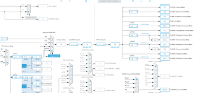

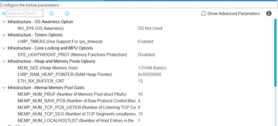

I'm developing an application for the STM32H755I-Q board in which I'm using the LwIP library (without an OS) to leverage the TCP/IP stack (for the configuration, I followed How to create a project for STM32H7 with Ethernet ... - STMicroelectronics Community).
After verifying that everything was working correctly, I decided to add log management via UART3 printing (according to the reference manual, USART3 supports the Virtual COM Port).
Unfortunately, when I try to print "Hello World", I only see unreadable characters in the terminal.
Below is the main:

1) MPU regions
2) USART3
3)LWIP
I believe there might be an issue with the use of USART and the MPU configuration, but I'm not yet confident enough with these aspects.
Does anyone have any suggestions? Do you need any other informations ?

2025-09-16 6:38 AM
Here there is my clock configuration
USART3 receives a clock of 18.75 MHz (the datasheet says that USART3 is connected to the APB1 bus), and so far I've been using a baud rate of 115200. I'm doing some research online to understand what the best baud rate is, but I haven't been able to figure out which one is correct. Should I be using a lower value than the one I've used so far?
2025-09-16 7:02 AM
There's no such thing as a "best" baud rate - it all depends on your particular context.
115200 is widely used, and widely supported.
What you need to check is what baud rate you are actually getting - does that match what you think you're setting?
