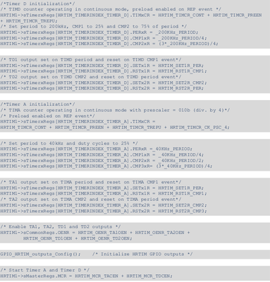

you misunderstood me. I am trying to make PA9-PA11 into an active state. to check this state, I use the o HRTIM_TIMxISR register. I was asking what actions I should perform in order for PA11 or PA9 to become active and I could see in confirmation of this
O1STAT: Output 1 Status
Output 1 was active
all actions taken together from your documentation do not lead to this. I'm not getting the result I should be getting. this means that the behavior of the microcontroller does not correspond to what is described in the documentation
2023-06-27 5:35 AM
for example, I'm trying to get PA9 to the active state in the simplest way. for example, an excerpt. in the register
HRTIM_SETx1R// the address is calculated 400175BCHRTIM_ODISR //0x40017918I'm setting the bit
Bit 0 SST: Software Set trigger
This bit forces the output to its active state. This bit can only be set by software and is reset by
hardware.according to your documentation, I would have to take in the registerthis should be an indicator here
or would there have to be changes in the register
HRTIM_ODISR //0x40017918but there is no reflection of this action anywhere. and PA9 is also not in an active state.
