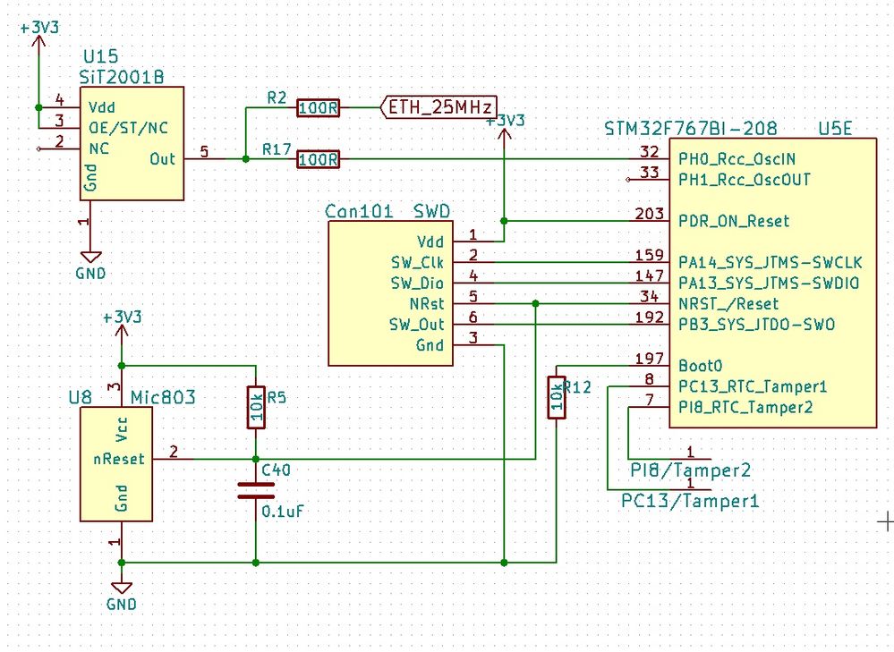

Hey T J, Could you please show me how you connect the chip with programming board? Just wondering if there is any difference in the connections that may cause the problem.
2018-01-16 11:31 PM
