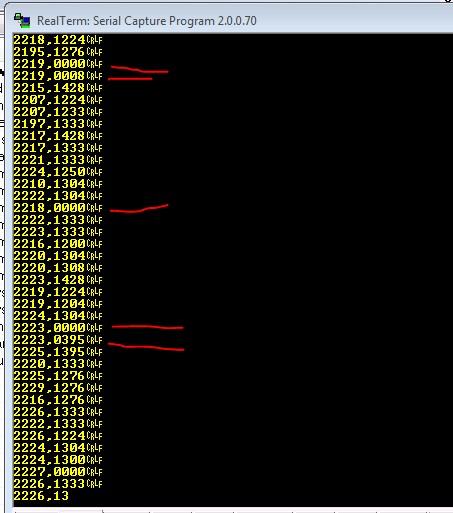

The problem i am facing is when displaying the data on the PC i get very often garbage data.
I have attached a small terminal data showing with red marking the garbage, and a simplified version of the code
How to overcome this?

regarding tmp[2] , this is 1 char + space for NULL , it is used to send one char on every dma transfer
i have tried to use a fixed value for rpm in the sprintf function, it seems stable.
After doing more debugging, i have moved most of the code inside the timer2 irq handler, now my DMA irq code looks like this
The DMA now works with the Buffer, i have removed tmp
The DMA when finishes the transfer, sets the flag to 0, normaly when the CC1 IRQ is triggering again, it will check for that flag, if the flag is reset, will process the new data, and prepare for a new DMA trigger, if not it will move on with the rest of the tasks

USART_DMACmd(USART3, USART_DMAReq_Tx, DISABLE); flag=0; }}It seems my problem is in the timer2 irq handler.
