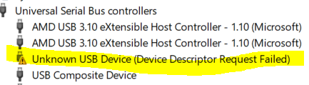

This my error message
This is my error:
2021-11-30 2:53 PM
As a quick check/fix, perhaps add a 250ms delay at startup before initialization of USB.
2021-11-30 6:56 PM
I don't know if this is relevant to your problem
I have a project which would run under debug, but crash on power recycle.
I used a GPIO driving my scope and found the program when running stand alone had a hard fault: unknown instruction.
Difficult to debug because the fault only occurred running stand alone.
By placing the GPIO write in different locations I found the problem code and fixed it. (Stackitis).
I don't know why it worked under debug, but no stand alone.
Hope this helps
Best Regards
Rob
2021-12-13 5:47 AM
Thank you everyone one for the answers you provided. The major problem was that the micro-controller started with the internal RC oscillator(clock) ; this can't work with USB as USB requires a more stable clock. So I used an external clock.
