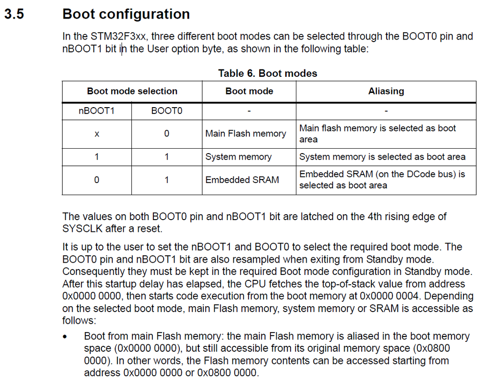

what did you do with pin 28 PB2/ Boot1 ?
this may be giving you trouble too...
2018-01-04 9:00 PM
I didn't connect anything to Pin28/Boot1, do I need to connect anything to it??

as long as you have Boot0 grounded, the processor will ignore the Boot1 pin.
