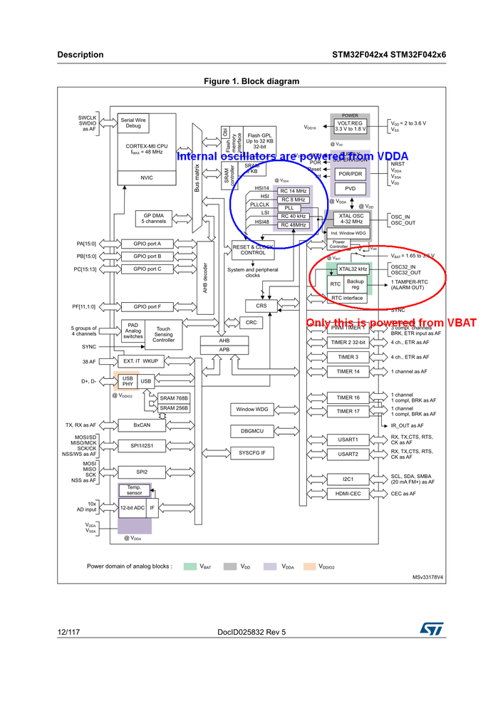

2022-11-25 3:53 AM
One more thing, which you maybe overlooked:
> Osc32 it's not a problem to me, I can calibrate internal oscillator with good aproximation for this aplication
No, you can't use any of the internal oscillators in VBAT mode. Only LSE works in VBAT mode.
