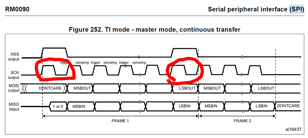

2021-11-18 6:07 AM
> Issue is when the NSS is high, Clock also present.
The "NSS" signal on the STM32F4 is not a CS signal. It pulses at the end of each byte in TI mode, which is presumably what you have selected. You'll need to use a different method.

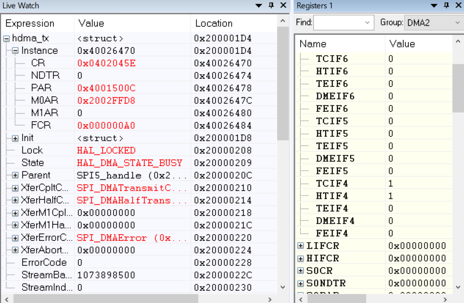

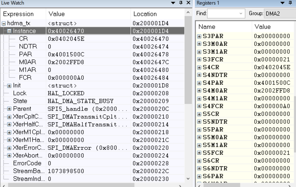

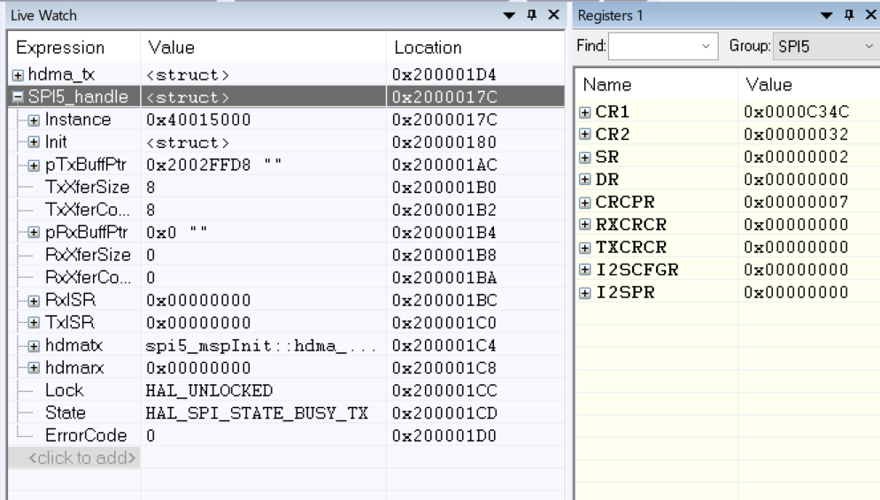

2021-11-15 5:08 AM
Hi TDX,
Thanks for the response.
MX_DMA_Init is done before MX_SPI_Init
DMA2 Stream 4 and SPI5 is used.
please find the above images attached.
2021-11-15 5:26 AM
The DMA stream isn't enabled. Might be some flags set in DMA2_HISR.
Since NDTR=0, it could be that the transfer is complete, but you don't have the DMA transfer complete interrupt implemented or handled correctly, or interrupts are disabled.

2021-11-16 5:40 AM
You appear to try to use SPI with CRC, is it intentional?
Do you use C++?
2021-11-16 5:47 AM
Since TCIE is set and TCIF is set, and the cpu isn't jumping into the handler, the corresponding NVIC enable bit isn't set, interrupts are disabled, or a higher priority interrupt is being ran.
2021-11-16 6:01 AM
Hi JW,
I use C language.
My SPI is configured without CRC (SPI_CRCCALCULATION_DISABLE)
2021-11-16 6:04 AM
Hi TDK,
The NVIC is enabled, I will check by modifying interrupt priority.
2021-11-16 7:43 AM
Sorry I misread the bits in SPI_CR1, indeed, you don't have CRCEN set (rather, BIDIMODE and BIDIOE).
