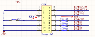

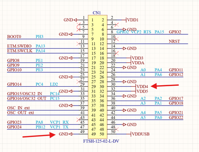

We powered the MB2130 board exclusively through pins 30 (VDD) and 49 (GND) of connector CN1. The NRST signal was held low by shorting pins 10 (NRST) and 9 (GND) of the unequipped CN4 connector. You can see the connection below:

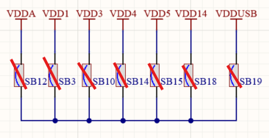

It is worth noting that the different power supply pins of the MCU are NOT short-circuited. The solder bridges SB12, SB3, SB10, SB14, SB15, SB18, and SB19 are open. Additionally, it has been verified with a multimeter that there is no continuity between these pins.

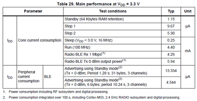

We have checked the datasheet and there is no information about the current consumption in reset state:
Is it 1 mA a reasonable value? It seems too high for us.

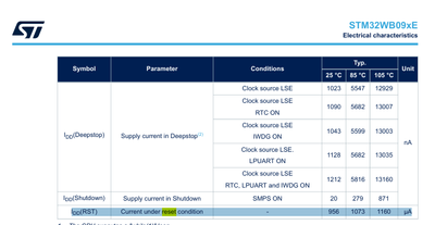

2026-04-22 1:02 AM
1mA is expected if setting reset pin to low.
Entering in low power mode should (such as 1uA in standby mode) be done through dedicated API.
Laurent

2026-04-22 1:25 AM
Sorry, just realized I mixed chipset with another topic.
I provided data for STM32WB09, but I would guess this is similar for WBA (agree data is not provided in datasheet)
I would suggest using dedicated APIs for entering low power mode.
https://wiki.st.com/stm32mcu/wiki/Connectivity:STM32CubeWBA_Low_Power_Management
