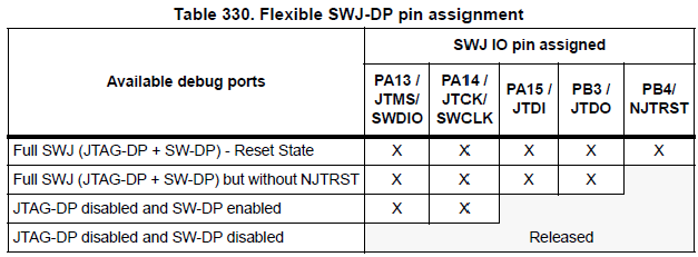

0693W00000WIpxXQAT.png...

48.4.2 Flexible SWJ-DP pin assignment
After RESET (SYSRESETn or PORESETn), all five pins used for the SWJ-DP are assigned as dedicated pins immediately usable by the debugger host (note that the trace outputs are not assigned except if explicitly programmed by the debugger host). However, the STM32L47x/L48x/L49x/L4Ax MCUs offer the possibility of disabling some or all of the SWJ-DP ports, and therefore the possibility of releasing the associated pins for general-purpose I/O (GPIO) usage, except for NJTRST that can be left disconnected but cannot be used as general purpose GPIO without loosing [sic] debugger connection. [emphasis mine]
I don't understand that last sentence. We're using 2-wire SW-DP, so we don't need NJTRST itself. Can we use PB4 as SPI3_MISO (does that count as general purpose GPIO?) without losing the ability to debug with SW-DP?

That's probably an infortunately formulated version of the "Full JTAG configuration without NJTRST pin cannot be used" erratum, see errata to your STM32.

Hello @CKugl.1​ , @Community member​ ,
After checking the reference and the errata: If only Serial Wire is used, PB4 can be used as a GPIO.
I confirm that the RM is wrong on Table 330 row 2 (should have a ‘X).
Imen

OK I see why the extra X in the table, although it may get even more confusing and perhaps granting a footnote to the table; but the real problem is the highlighted text in the original post: it now effectively says, that using PB4 as GPIO results in losing [all] debugger connection, whether it's SWD or JTAG - and that is not the case, is it.
