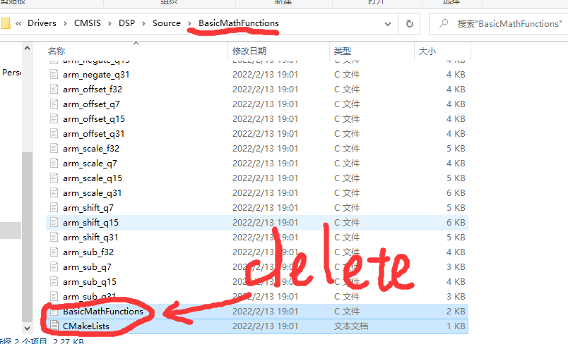

I have used DSP in STM32F411 successfully,but when i want to use DSP in STM32G070 , i find the DSP files are some different,such as G070's DSP files : ./Sourse/. have a Cmakelists.txt. i dont know how to use that txt file, so i just add DSP as usual.

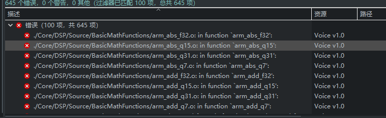

but! when i try to compile , it has 757 errors! How amazing!
so,could anyone can tell how to do?thanks all !
2022-03-06 7:36 AM
Thank to answer, I have solved this problem. I delete some files such as .\Source\BasicMathFunctions\BasicMathFunctions.c .\Source\CommonTables\CommonTables.c ......
I just delete each .c file which sames as folder name from .\Sourse
Anyway,after i delect , i can compile !
By the way, i just do that ways which you put in your answer.
thank you very much!

Hard to tell if that's linker or compiler errors, assuming linker
You shouldn't need to build the library from scratch, should use pre-built
STM32Cube_FW_F0_V1.11.3\Drivers\CMSIS\Lib\GCC\libarm_cortexM0l_math.a
Then use the example code.
Typically people build the library itself via command line make methods.
https://community.st.com/s/article/configuring-dsp-libraries-on-stm32cubeide
