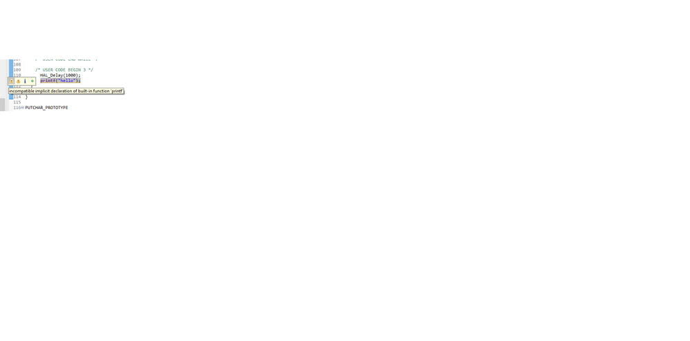

 Also, might be worth to mention that I have got a warning message under the printf:
In syscalls.c I have placed breakpoints on functions _write and _read. None of these functions are invoked after calling printf. I am not sure whethet thats the expected behaviour. Also, I have placed a breakpoints in HAL_UART_Transmit function and it never gets called either

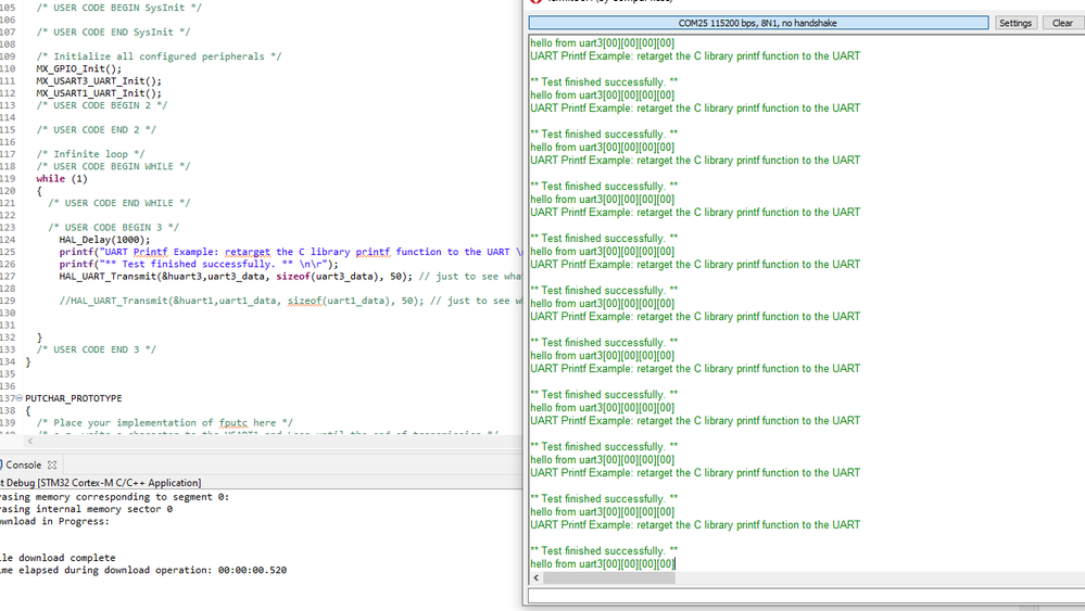

I have been examinating it further and tested UART using terminal "termite".. From the datasheet I have found out something about usart3:
0693W000006HqMbQAK.pngAnd I am able to see the usart messages on the terminal
I am not sure whether thats a good sign or not, but I am still not able to see any messages on the debugging console window on the cubeIDE.

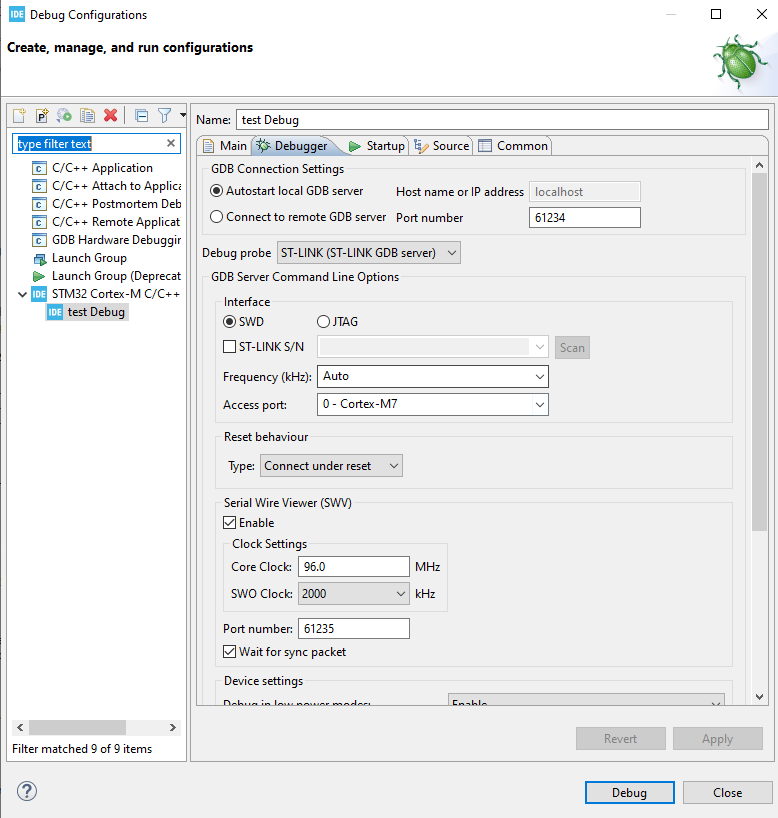

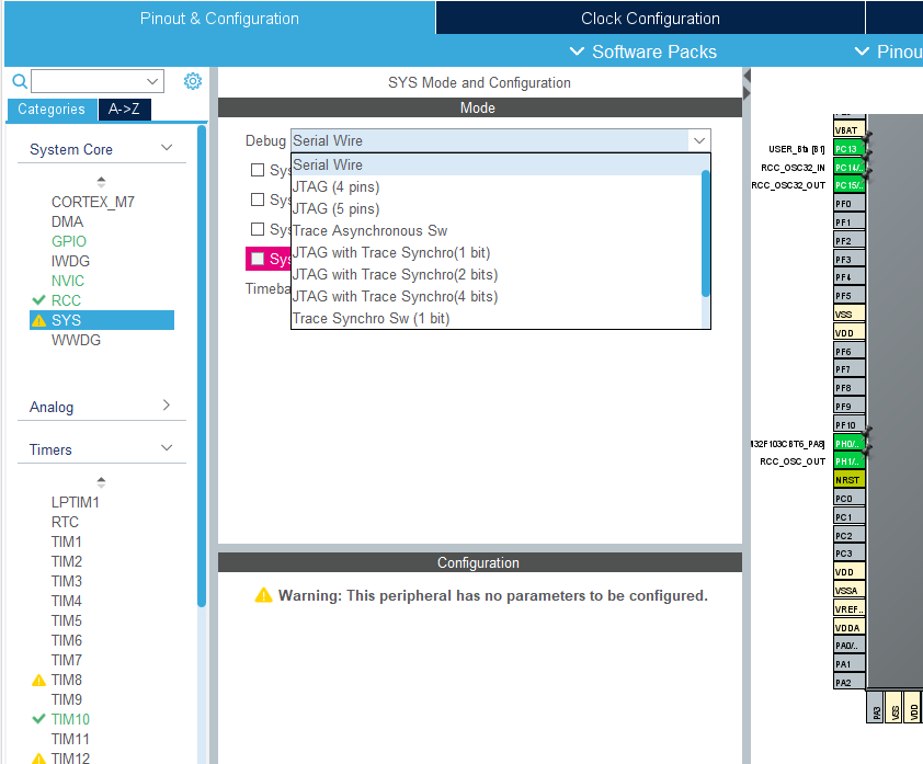

  1. Enabling the tracing and setting the sysclk frequency
However, still no luck doing printf to the console.
Also, I would like to ask whether there is a difference which debugging option I chose?:
