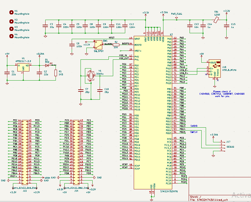

I have a simple STM32H753VIT6 board with simple power circuitry and USB connection also 25Mhz xtal.
I can program the board in DFU mode and verifies fine. I do not have the LSE xtal. not sure if it is needed for the USB operation. Complete circuit diagram attached. Can any one help me why am I failing with such a simple board.

Just - whats on pins VCAP , Vref+  ?
Like in the circuit diagram they are floating and not connected. Thanks for reply. This is the complete circuit diagram.

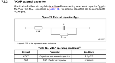

Thats wrong.
Need caps on VCAP . (core supply !)
see ds ...
Without caps...any random behavior possible... :)

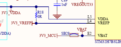

Vref+ -> see manual, if you want any analog function on yor chip, like ADC ...
usually vref+ on Vdda = Vdd :
