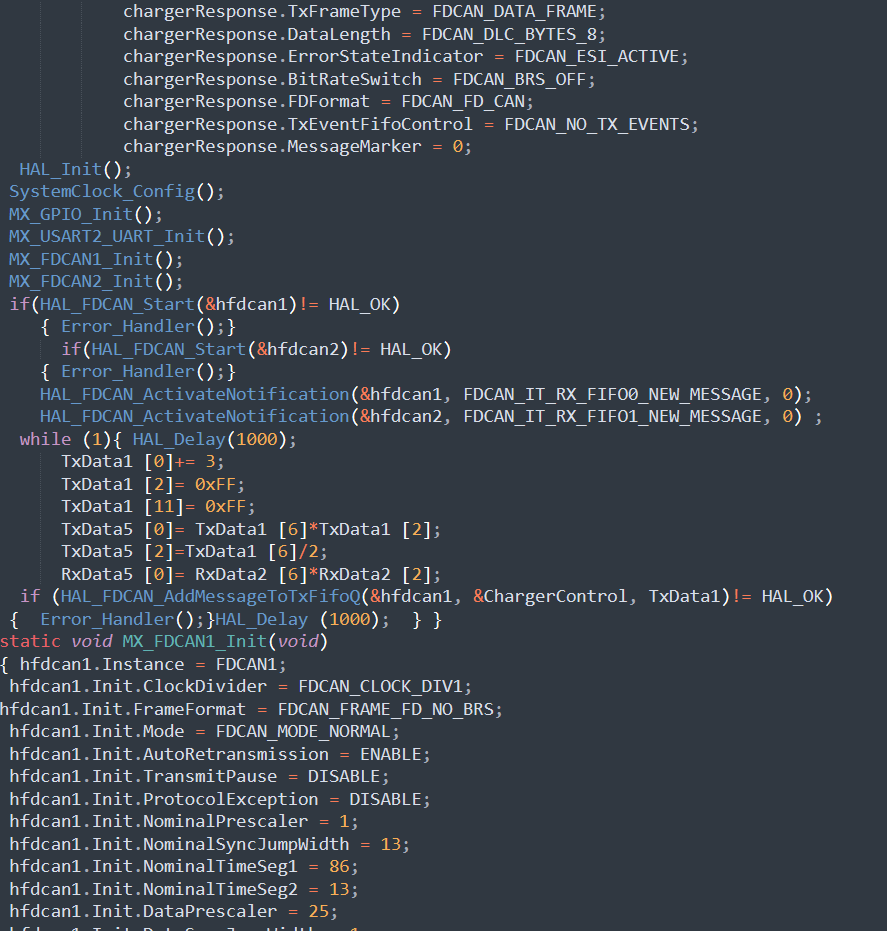

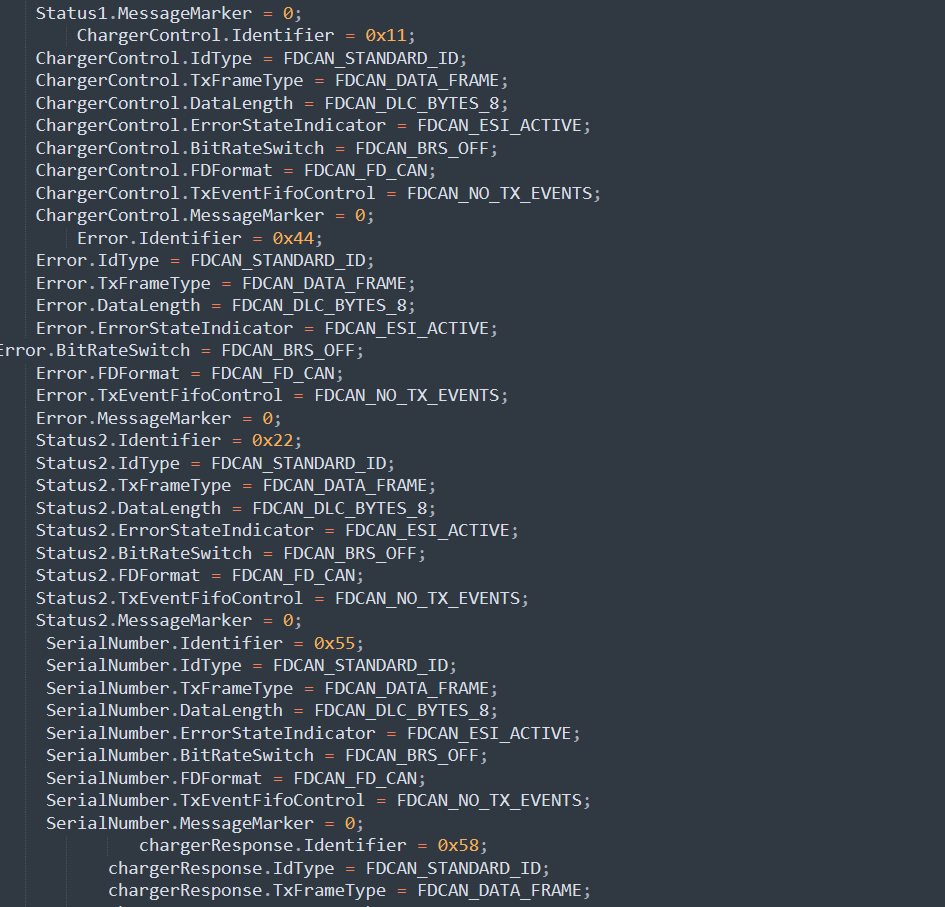

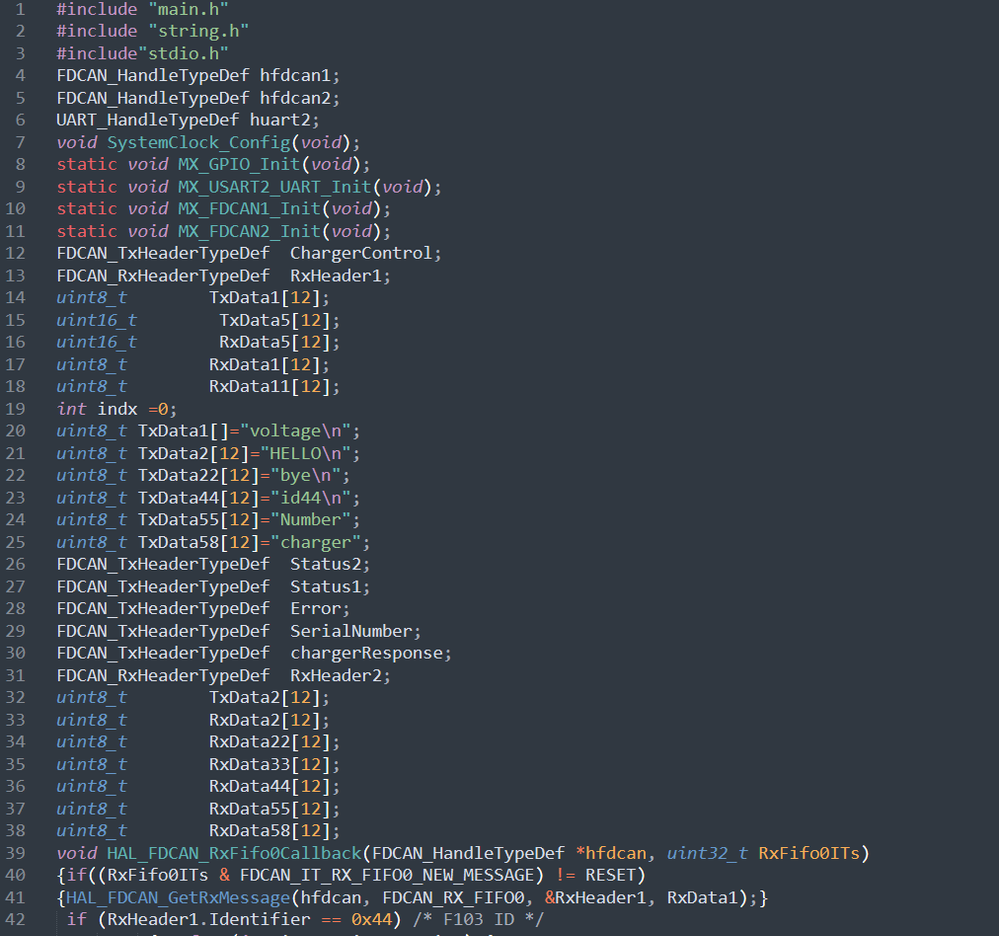

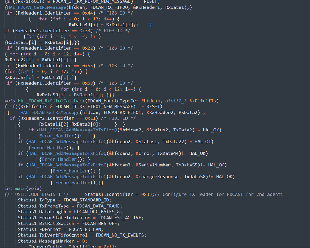

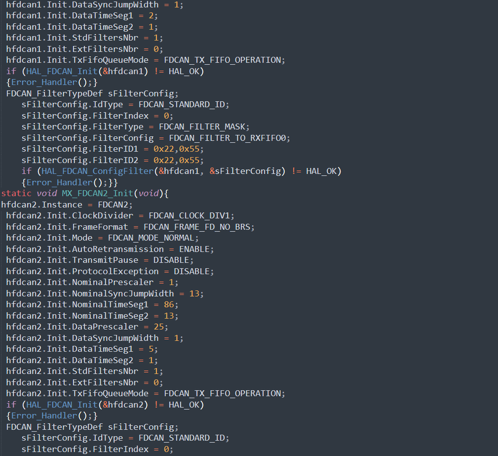

i am able only send 3 frame but i want send 5frame ,what i am doing wrong ?
if (HAL_FDCAN_Init(&hfdcan2) != HAL_OK)
{Error_Handler();}
FDCAN_FilterTypeDef sFilterConfig;
sFilterConfig.IdType = FDCAN_STANDARD_ID;
sFilterConfig.FilterIndex = 0;
sFilterConfig.FilterType = FDCAN_FILTER_MASK;
sFilterConfig.FilterConfig = FDCAN_FILTER_TO_RXFIFO1;
sFilterConfig.FilterID1 = 0x11;
sFilterConfig.FilterID2 = 0x11;
if (HAL_FDCAN_ConfigFilter(&hfdcan2, &sFilterConfig) != HAL_OK)
{ Error_Handler();}}

Your mix of screenshots and code really s*cks...
Anyway...
I guess your TX FIFO queue is filled up and won't empty because the CAN messages you sent are not ACK'd by a receiver.
Have you checked with a scope what's happening on the CAN bus?

Suggest you check FIFO depth, and if the prior messages were sent yet, or if you need to implement a queue and send new packets in the callback.

LCE is correct. You have a 3 message mailbox, without and ACK that buffer stays full. You have 2 choices, purge the mailbox or put the CAN peripheral in Loopback mode.
