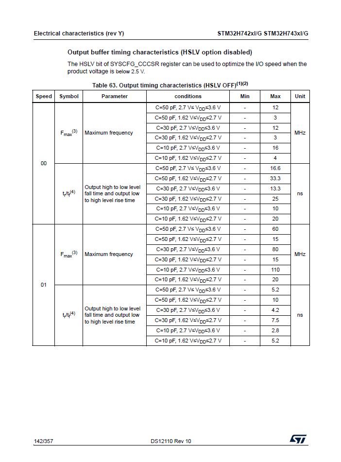

2023-05-11 12:49 AM
Check the datasheet / reference manual about the GPIO speed settings. These are register settings, so you will find a description.

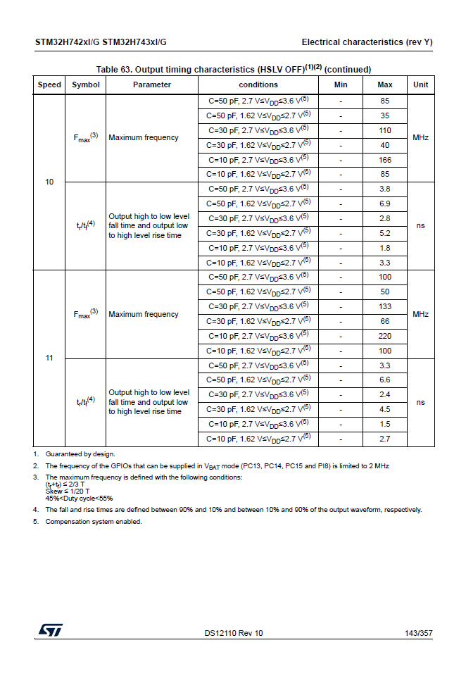

2023-05-11 1:18 AM - edited 2023-11-20 5:45 AM
I see maximum speed 220 MHz
