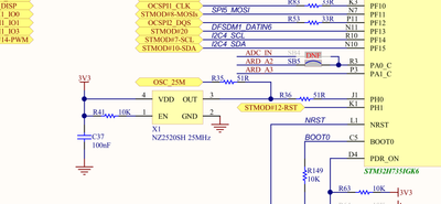

Indeed you are using HSI. It’s recommended to use HSE and a crystal for CAN communication. I don’t have my PC now (i’m posting with my phone) but the disco board has already a crystal (crystal oscillator XO).
So please use it instead of HSI:
You shoud select HSE in bypass mode and set the crystal value to 25MHz in the clock view.

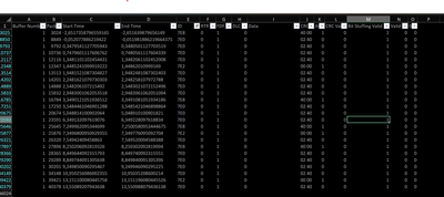

Please see the file attached , filter ID column with 7E and select all. You will see that DLC 0 and DATA empty and CRC invalid , not ACKed and Valid 0.
TEC increased more than 127 , goes to error passive after a few milliseconds.
02 01 0C with first byte 02 means it is a request for RPM in live mode (show current data). I don't even flood the bus since my requests are periodic with 1s , and i address it to each physical address from 7E0-7E7 and 7DF(broadcasting to all ECUs)
Which means you almost certainly have a problem with the physical signal, either wiring, or missing/improper termination resistance.

@Ozone wrote:> TEC increased more than 127 , goes to error passive after a few milliseconds.

2026-03-04 12:49 AM
> It is fine , otherwise my oscilloscope would have not decoded the frames and the FDCAN present in the board would have not received the frames and logged via USART3 VCOM .
The other side (the car) seems to disagree.
And TEC / REC are going up on physical signal errors.
What you see on one end is not necessarily what the other side sees.

Sorry I didn't see that post:
So you have communication errors!

I’m providing all the sources of issues that can face with the communication and also I cited a possible issue of a bitrate mismatch. But that doesn’t make sense if his can node is receiving well the frames from the car. That seems to be not a baudrate issue but more related to a jitter or something similar.
