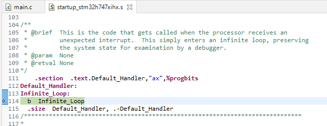

}Even it falls into a infinitive loop:
If I comment out "__HAL_TIM_ENABLE_IT(&htim8, TIM_IT_UPDATE)" then there is no inf. loop, but the callback is never hit.

2021-07-29 8:07 AM
It's in an interrupt handler that you didn't define so it defaults to Default_Handler.
Ensure TIM8_UP_TIM13_IRQHandler is defined appropriately.
2021-07-29 8:56 AM
Hi TDK!
Super, as always, you are right, I used void TIM8_IRQHandler(void) which does not exist. Defining void TIM8_UP_TIM13_IRQHandler(void) solved the problem. One note: I still have to call __HAL_TIM_ENABLE_IT(&hTimer8, TIM_IT_UPDATE). Without this the callback function is never hit.
