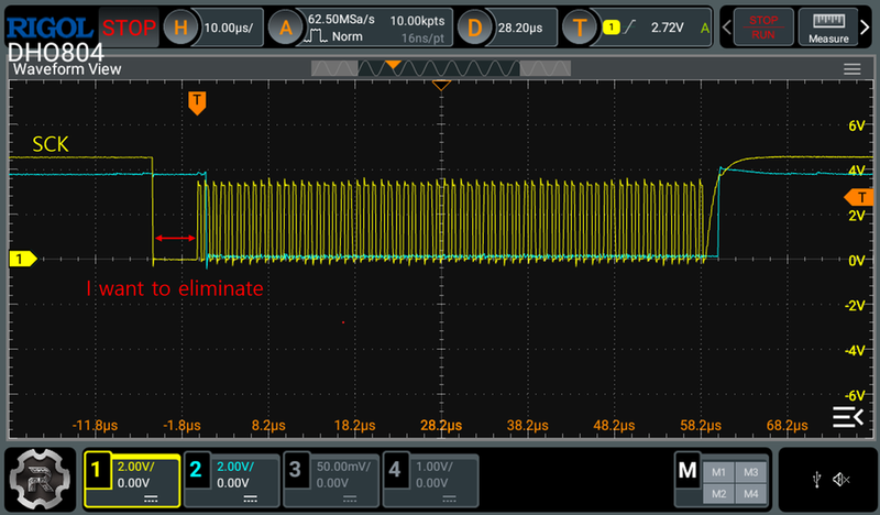

I am using an STM32H7 MCU with STM32CubeIDE to communicate with a BiSS-C encoder in SPI RXONLY Master mode.
My goal is to generate 64 SCK clocks every 10ms without delay.
However, I am observing the following issue:
Each time I call HAL_SPI_Receive(), SCK stays low for around 10 microseconds before the clock output starts.
This happens regardless of SPI speed.
At 1MHz SPI clock, the delay is around 10us.
At 2MHz SPI clock, the delay reduces to about 5us.
But there is always some delay before the first SCK pulse.
The same code and settings on an STM32F103 board do not show this delay.
I already tried RXONLY and FULLDUPLEX modes, manual NSS control, enabling and disabling NSS Pulse mode, but the result is the same.

2025-08-05 10:25 PM
Thanks for your reply.
I don't necessarily want the idle state to be high.
What I want is for the SCK signal to start toggling immediately when I call `HAL_SPI_Receive()`.
But currently, there is about a 5~10µs delay where SCK remains low before any clock edges appear.

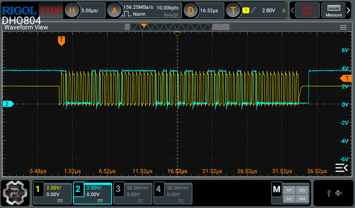

When I use the same SPI settings on the STM32F103 NUCLEO-F103RB, the clock signal is generated without any delay, as shown in the screenshot below.
I don’t understand why this delay only happens on the H7 board.a

2025-08-06 6:47 AM
I don't think the H7 can achieve what you want. What good is a floating clock pin? What are you interfacing with?
2025-08-06 7:06 PM
Thank you for your reply.
I initially thought the pull-down could be configured via the board settings, but that wasn’t the case.
I didn’t realize the clock pin was floating — that never occurred to me. After connecting a pull-down resistor, the issue was resolved.
I’m not sure why the F103 board doesn’t have this problem.
Also, I tried using a pull-up resistor, but it didn’t work — only the pull-down works. It’s quite unusual.
