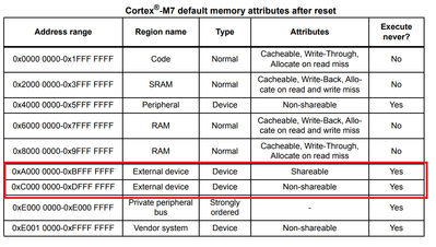

FMC memory region defined as cacheable by default? for example these regions are not cacheable by default:
PS: the FMC on STM32F7 product is connected on AHB and not on AXI like the case of STM32H7.
For performance aspects, please refer to the application note AN4667 "STM32F7 Series system architecture and performance"

I use the 0x6C000000 region which is cacheable by default.
Using the MPU with settings:
TEX : 0
Sharable: Enable
Bufferable: Enable
Cacheable: Enable
made the fault to occur less frequently.
