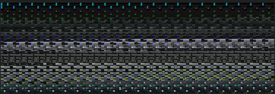

With this code, I got this jpeg image:
The file header, resolution looks okay, but the content is corrupted. And I am not sure why.
Any idea?
2025-06-18 5:51 AM
I found a solution. Basically my implementation was correct. The example code brings too much complexity, it is not easy to integrate... Anyway, the issue that I was facing is related to cache issue with dma. I had to clean the dchache each time I created an MCU block. Something like this:

2025-06-18 5:51 AM
ExtractMcuToBuffer(inputPtr, mcuBuffers[bufferIndex], currentMcu);
// Critical: Clean cache after buffer generation
SCB_CleanDCache_by_Addr((uint32_t*)mcuBuffers[bufferIndex], MCU_SIZE);
