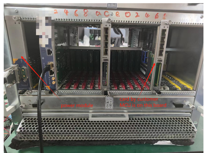

the last question you asked, I also want to know, but now only the original equipment manufacturer could answer this. I used some commercial system chassis and system as shown below:

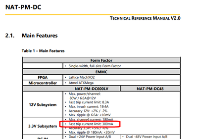

The Technical Reference Manual suggests that it shouldn't trip until 300mA:
So even less likely that's down to the microcontroller starting up!

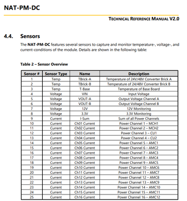

The TRM also says there's  a load of current sensors built in:
Could they help you?

Yes, it has current sensor built in power module, but it didn't say how I can read the current value it measured.
