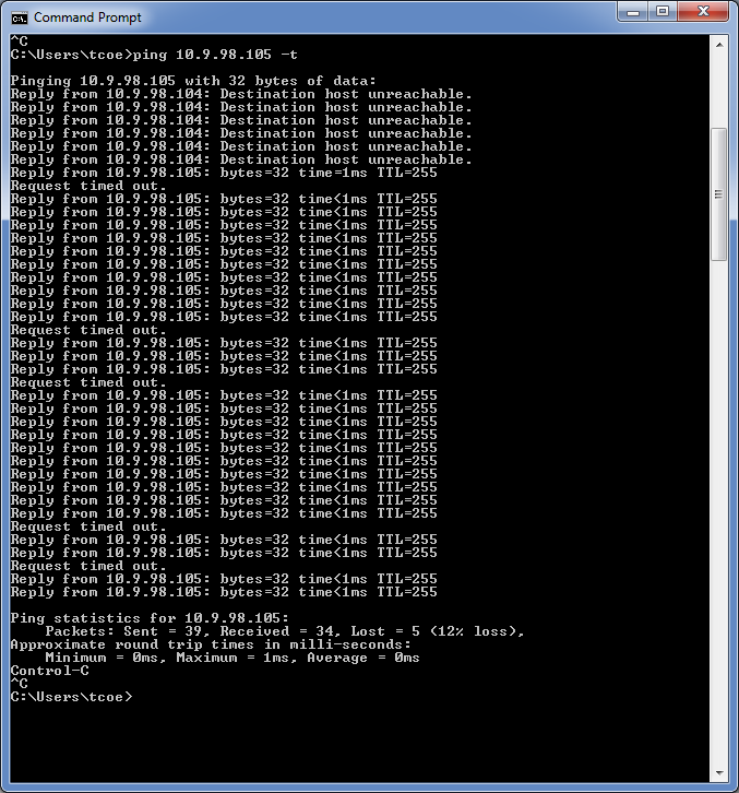

We are facing data loss issue while ping test was conducted on the STM32F407 with lwip stack 1.4.1
The stack was downloaded for STM32F407 Evaluation Board Code from www.st.com site after changing pin configuration [used tftpserver standalone code] flashed into STM32f407ZE controller found that 10% of data loss.

Its usual ping message to the ip to check connectivity with server. The same test was conducted on STM32F107 board with lwip 1.3.1 the data loss was nil. PFA for the ping test
2018-09-05 2:37 AM
Attached file here
