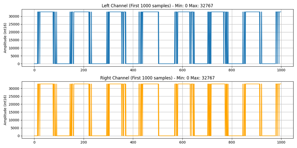

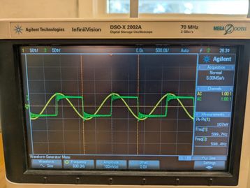

I am trying to capture data from the LINE_IN (blue jack on board), but I am not receiving the correct input. I evaluated my output at the oscilloscope and noticed that I am not receiving the sinusoid I am injecting; the frequency is correct, but the data appears clipped, as shown in the picture. I tried to reduce the Vpp, but it just started getting noisy instead of giving the correct input.
My second test was to record on the sd card, and the problem persisted; I am only getting data above zero and noise

EDIT: The problem was this function, I needed to configure the BSP_AUDIO_OUT_Init first

Hello @JacquiG29
It seems you find out the root cause of the issue : the initialization order of the audio codec paths. On this board, the playback and capture paths share codec resources, so it is important to initialize the output path first:
