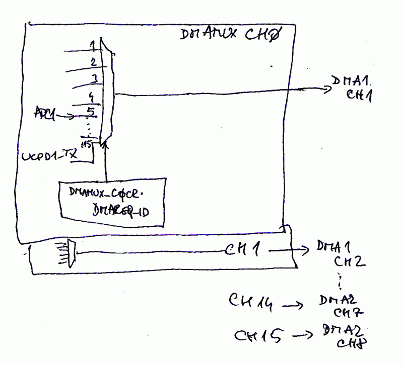

As Piranha said above, for each DMAMUX thus DMA channel you select, which peripheral will trigger it, in the DMAMUX_CxCR.DMAREQ_ID. That's all you need to do with DMAMUX, unless you want to use some of its fancy advanced features.
The inputs mapping is in DMAMUX: assignment of multiplexer inputs to resources table. Zero is reserved, it means that the given channel is switched off.
The mismatch between DMAMUX channels numbering (starting at 0) and DMA channels numbering (starting at 1) is, ehm...
