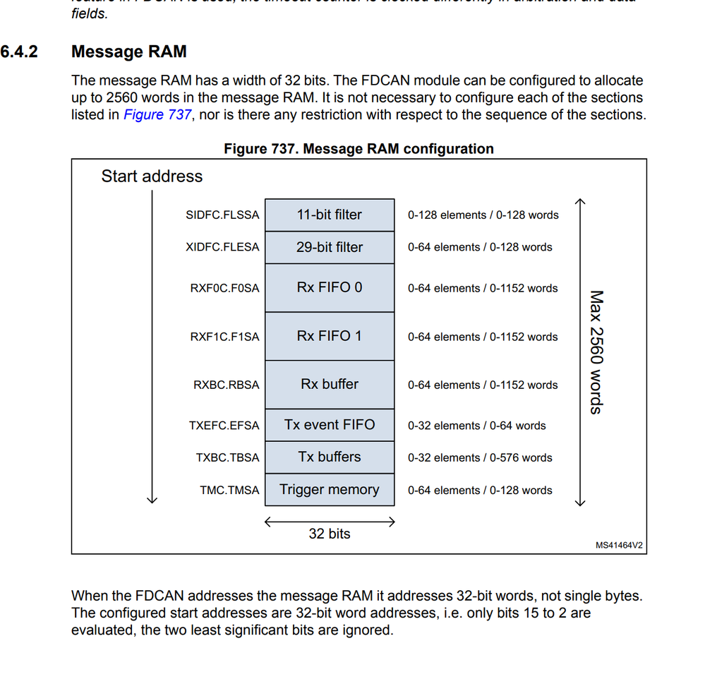

2025-07-05 1:18 AM - edited 2025-07-05 1:59 PM
RM0433
2459
________
This is an example of initialization code for FDCAN for STM32G4 series.. but the principle is the same
void CAN_Config(void) {
FDCAN_GlobalTypeDef *CAN = FDCAN1;
uint32_t *filterRAM = (uint32_t*) RAMBaseFDCAN1;
RCC->APB1ENR1 |= RCC_APB1ENR1_FDCANEN; // Enable CAN
RCC->CCIPR &= ~RCC_CCIPR_FDCANSEL;
// PLL "Q" for FDCAN
RCC->CCIPR |= (0x1 << RCC_CCIPR_FDCANSEL_Pos); // PLL "Q"
CAN->CCCR |= FDCAN_CCCR_INIT;
while (!(CAN->CCCR & FDCAN_CCCR_INIT))
CAN->CCCR |= FDCAN_CCCR_CCE; // Config mode
Baudrate NSJW NBRP NTSEG1 NTSEG2 FDCAN_NBTP (uint32)
125000 1 640 543 95 0x21F5F
250000 1 320 271 47 0x10F2F
500000 2 160 67 12 0x08617
800000 1 100 84 14 0x0540E
1000000 1 80 67 11 0x0430B
// Set the nominal bit timing register
CAN->NBTP = (1 << FDCAN_NBTP_NSJW_Pos) | (1 << FDCAN_NBTP_NBRP_Pos)
| (66 << FDCAN_NBTP_NTSEG1_Pos) | (11 << FDCAN_NBTP_NTSEG2_Pos);
// Clear RAM
for (uint8_t i = 0; i < 212; i++) {
filterRAM[i] = 0;
/* FDCAN global filter configuration register (FDCAN_RXGFC)
Address offset: 0x0080
Reset value: 0x0000 0000
CAN->RXGFC = STDfilter_n(2)|EXTfilter_n(0)|ANFS_Reject_rx|ANFE_Reject_rx;
// ID filters 100 and 80
filterRAM[0] = STDfilterID_DUAL | STDfilterRxFIFO0
| STDfilterID1(0x100) | STDfilterID2(0x80); // ID = 100, Standard ID, Store in FIFO0
CAN->IE |= 3; // FDCAN_IE_RF0NE_| RF0FE
CAN->ILS |= 1; // RXFIFO0: RX FIFO bit grouping the following interruption
CAN->ILE |= 2; // Enable IT0
//FDCAN1->IE |= FDCAN_IE_RF0NE;
// Normal mode
CAN->CCCR &= ~FDCAN_CCCR_INIT; // exit init
while (CAN->CCCR & FDCAN_CCCR_INIT)
NVIC_EnableIRQ(FDCAN1_IT1_IRQn);
}But your memory size is different.
