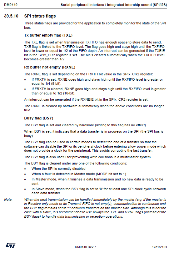

@Tommino "How is this prevented?"
There'll be a status bit that tells you when a transfer has completed.
On this chip, you also have read & write FIFOs
