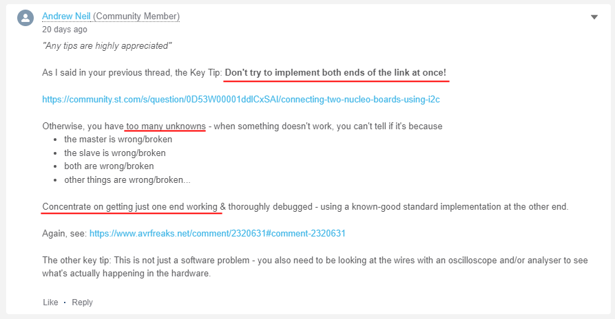

I would strongly suggest that's not a great starting point - you are giving yourself too many unknows all at once!
This comes up frequently!
It would be far better, I suggest, to:
Probably the easiest starting point would be to use the Arduino and its UART to communicate with a terminal on your PC.
