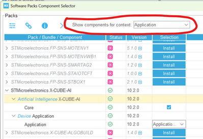

Have you selected the software pack for the correct context?

Have you selected Application here?
