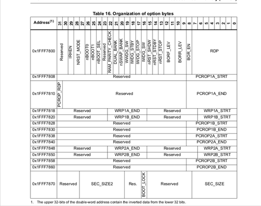

I wanted to enable the write protection option byte using I2C bootloader ( Bootloader given by stm32). This can be done using the stm32 debugger also. but in my case requirement is using I2C bootloader only.
MCU : STM32G0B1CET6
communication protocol: I2C
previously I have updated the user configuration option bytes using the same method(i2c bootloader). in which I have given the register address and the value. in that case, the option byte was updated as per the expectation.
For the write protection option byte, I tried multiple times with the same method and checked the write protection option byte using a debugger, but it is not updated(it remains as default).
below is the snapshot of the option byte register address. I am using the 0x1FFF7818 address to protect the first two pages.
1) Are there any additional steps I have to perform to enable the write protection?
2)does anyone have any idea how to do that?
If anyone has any ideas, please let me know. Applying this feature is a priority for us. and currently, we are blocked with this.

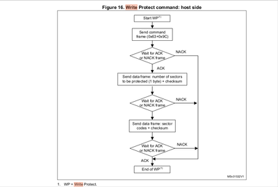

the below snapshot shows the write protection command using the I2C system bootloader. Which can be achieved by three steps.
1) Send the write protection command (0x63 + 0x9C)
2) Send the number of sectors to be protected and checksum (0x01 + 0xFE).
3) Sector code and checksum.(0x01 + 0xFE)
I performed these three steps. I have received the ACK response from a device for the first two steps.
For the third step, I am not getting any response from the device.
Do you/anyone have any idea why the device is not responding for the last step? Am I missing anything?
Note: I am trying to write protect the first page of flash memory.
