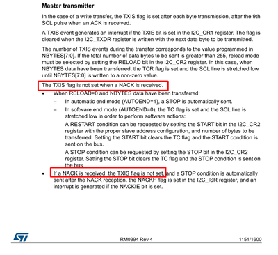

So, after effective NACK from slave, we have NACK+STOP+TXIS.
The documentation says, that NACK won't set TXIS. It says it *twice*:
What did I overlook?

Can you please comment also on what's the original topic of this thread, i.e. that the RM's claim that NACK won't set TXIS is incorrect?

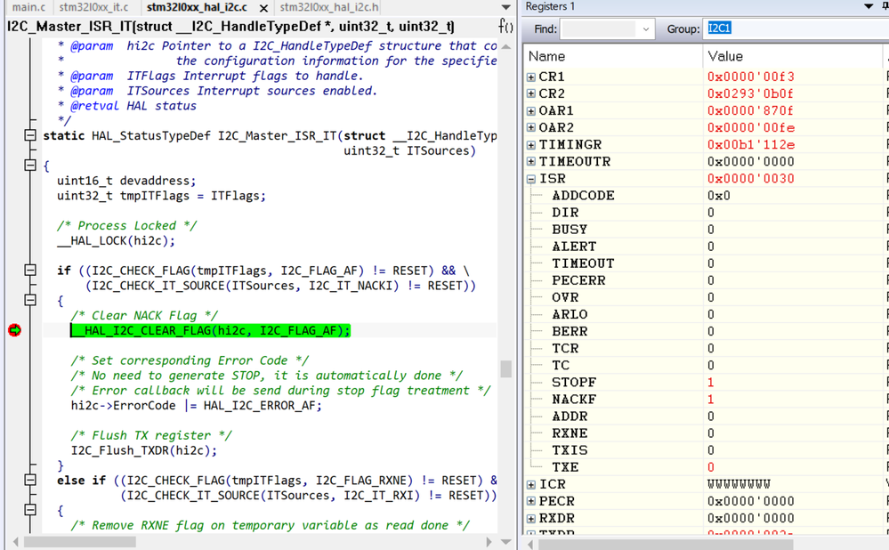

Hello @waclawek.jan
I tried to reproduce the problem you reported, but each time I generated a NACK, the master was like this. I tried different conditions, but I probably couldn't precisely reproduce the disconnection you referred to. would you care to post some screenshot from scope or logic analyzer?
That's because your ISR already had served the TXIS in question. Proof is, that TXE is 0, i.e. there is already a datum in the holding register, which will never depart, as the internal machine already issued STOP. (This actually is one of the consequences of this whole issue: if you start another I2C transaction without resetting I2C, the byte which is already in the holding register will be immediately transmitted instead of address).

Oh, no, no, this is a perfectly legal behaviour, the receiver - here slave - can issue a NAK any time, as it wishes; see UM10204 (the I2C specification), chapter 3.1.6 Acknowledge (ACK) and Not Acknowledge (NACK), conditions 3 and 4.
> and we cannot be expected to cover in our documentation every single error condition caused by that.
But my complaint is *not* that ST doesn't document the behaviour upon NACK; contrary: as shown in the initial post, it *does* document it, but incorrectly...
