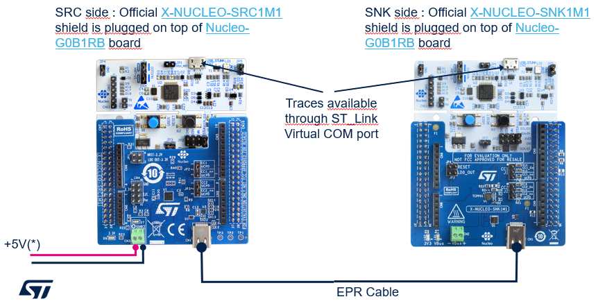

I'm working on new knowledge base article on How to create an EPR capable USB PD Source and Sink on STM32 using TCPP ports . For demo, VBUS is kept at 5 V even for higher SPR/EPR PDOs; only the protocol is exercised (not full EPR explicit contract).

Can you replace your source and attach it to the Sink with the proposed setup?

Unfortunately I have only setup for SINK. For my solution I have my own PCB with STM32G071KBT6 uC. Also I have no DPM_Ports. In USBPD_CORE_DATATYPE_RCV_SRC_PDO_EPR I have only 4 bytes of data.
Best regards
