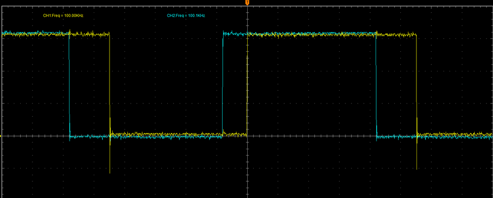

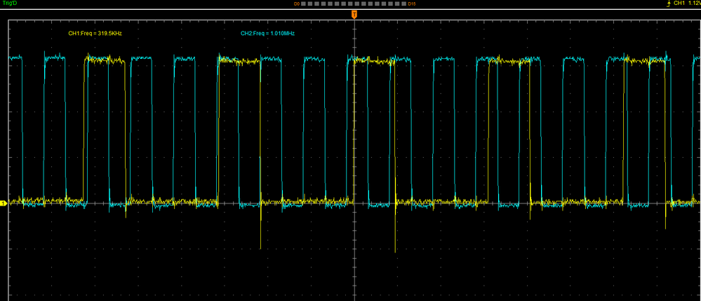

I've tried to use tim input captuer clock and using signal generator test it, stm32 only can follow 100kHZ.
Should I use 800mhz mcu to do it? Or only FPGA can do this job.

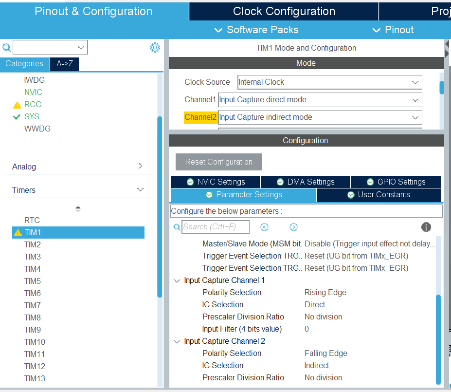

TIM config.
100khz result. (yellow is from stm32, blue is from signal generator)100mhz result. (yellow is from stm32, blue is from signal generator)

Your 100kHz result isnt right. Too your callback capture IF isnt ideal.

The freq. limiting factor in your code is the software, not the timer, especially when using HAL IRQ and the GPIOC access.
Anyway, I doubt that LVDS (camera link?) processing can be done in MCU software for any reasonable camera frame sizes and frame rates.
I would recommend looking into a LVDS deserializer chips interfacing to an STM32 MCU with a DCMI interface, or an FPGA solution.
