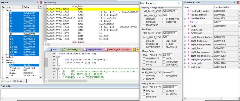

I am using Keil MDK IDE (with FreeRTOS and LwIP and OSPF routing protocol). The MDK call stack screen capture is shown in the following image.
The call stack shows that 0x0801B758 of uart1SendChar cause the UNALIGNED Usage fault.
The instruction at address 0x0801B758 is as follows which is used to get the value of USART1->SR:
0x0801B758 8809 LDRH r1,[r1,#0x00]
Since the USART1 is a peripheral structure and SR (Status Register) is the first element, I cannot figure out how could this instruction cause the UNALIGNED Usage fault?

Finally, after I have changed the task stack size of the new added OSPF task from 500 to 2000, everything goes fine. However, I still cannot figure out how could task stack overflow cause the above strange phenomenon.
