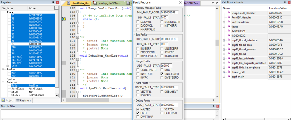

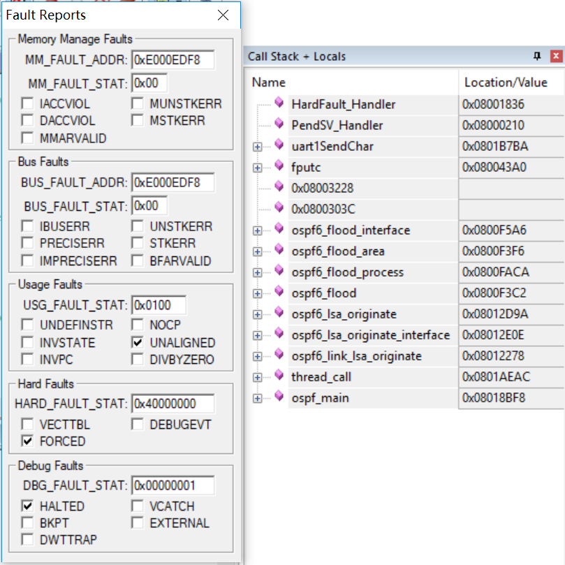

I found there is a Fault Reports in MDK as shown below with Call Stack. It can be seen that a Hard Fault is invoked and it is FORCED which means I should check other fault. Usage Fault is also invoked and it is an UNALIGNED access usage fault.
From the right of the above image, it can be seen that the call stack is very deep. Since uart1SendChar is tested before many times, so I guess somewhere of the new added ospf function may change the memory of others. Then, what should I do next to find which part of the code is wrong?
The following is the uart1SendChar code which is very simple. Then which memory of the following code is corrupted will cause the UNALIGNED access usage fault?

After I have check further with my hard fault, I found out that my hard fault is a FORCED one and is escalated by Usage fault which is UNALIGNED. The following image is the screen capture after I enable the Usage Fault.
However, do you known how to find which line of code or which assembler instruction that cause this UNALIGNED fault?

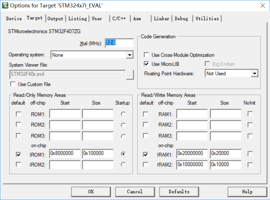

I checked the project setting and found that I am using Micro LIB, not the standard ARM C library. The following image is my project options setting.
The Keil website says that Micro LIB has support for printf (http://www.keil.com/support/man/docs/armlib/armlib_chr1358938940288.htm). However, how could I check the buffer size of printf in Micro LIB?
