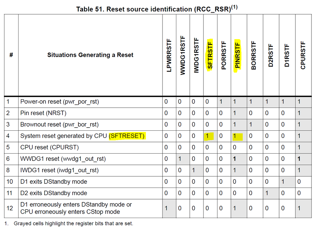

That's just how it works. PINRSTF is set on most types of reset. Examine all flags and match up to the expected pattern for the given reset type.

What kind of document is the screenshot?
That’s in the stm32h7 reference manual.
