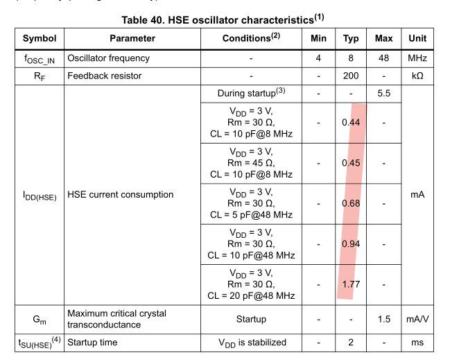

One more consideration. "Power consumption in oscillators is essentially a linear function of frequency".
Example From STM32G4 datasheet:
If you're working to minimize power consumption, an extra 200uA can be very substantial.
